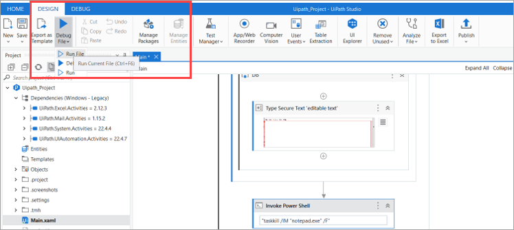

  1. The Text field is where you can instruct the Notepad to display the newly saved variable.
  2. Select Run File to test the Secret Server connectivity.

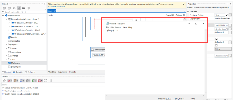

  3. A Notepad should display with the password value from Secret Server.

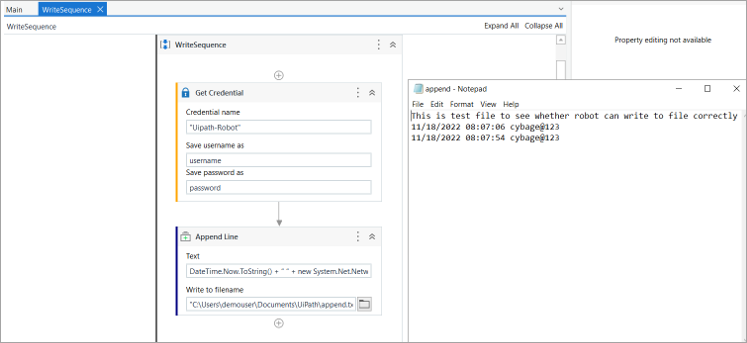

When the integration is functioning, the next test is whether the Robot can correctly carry out a Get Credential action unattended. For the second example, we will use the same Get Credential activity but pair it with the “Append Line” activity.
If this is a new Sequence, a new SecureString variable needs to be created.
  1. To configure the Append Line activity, the following information is needed:
    • The file you want to append a line to (for example, a Notepad file that was previously created).
    • The text you want to append. A time and date stamp are helpful to make sure that the Robot wrote to the text file at the correct time. The following text is a useful test:
      DateTime.Now.ToString() + “ “ + new System.Net.NetworkCredential(string.empty, notepadPass).Password
  2. Select Run File.
  3. The UiPath Studio will pause for a moment and then reopen.
  4. Check the text file to ensure that the change was made.
