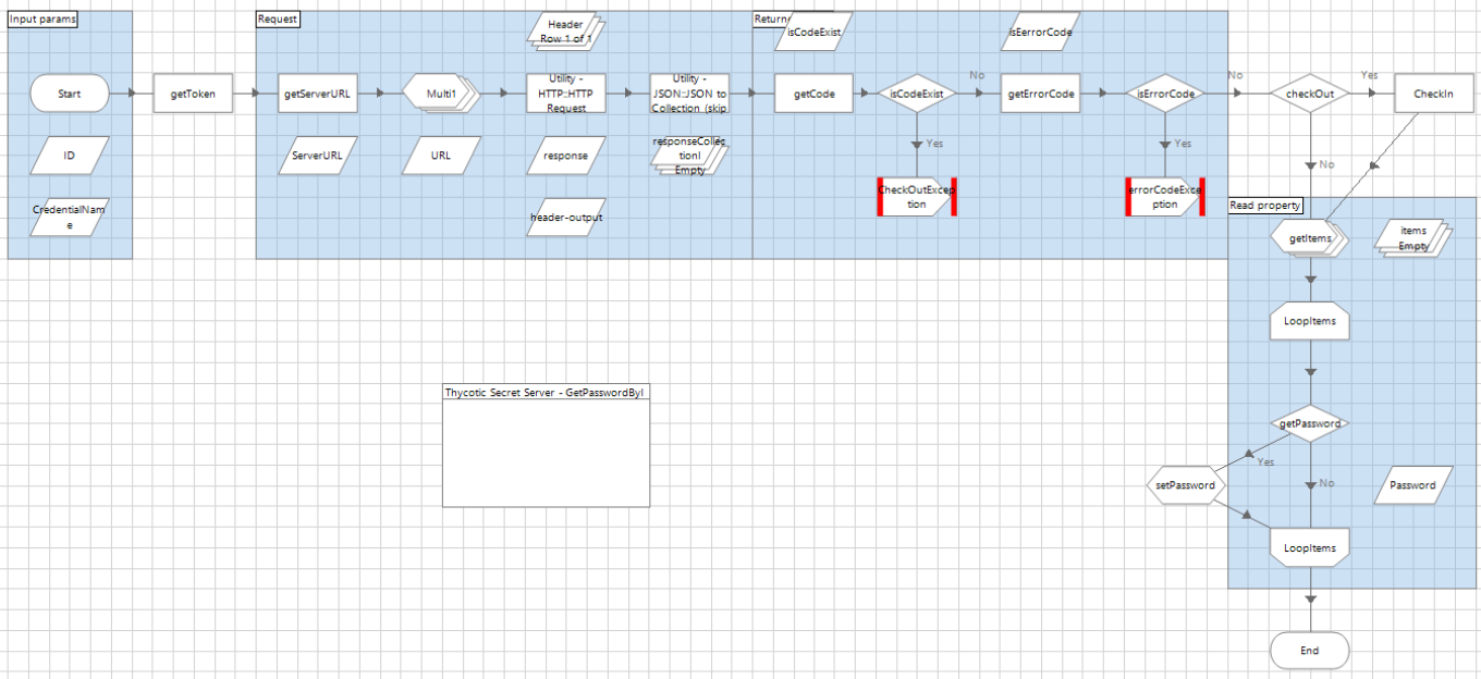

Check-Out
This method checks out a secret.
REST API URL /api/v1/secrets/<ID>/check-out
Input params
<ID> ID secret for operation, ID number
  • CredentialName: Credential name where the store accesses the parameters\
  • Property username: Accesses parameters store in the credential vault for Blue Prism
  • Property password: Accesses parameters store in the credential vault for Blue Prism
  • Property server_url: Accesses parameters store in the credential vault for Blue Prism
See the following settings for the Output parameters:
  • Exception: If request returns error code, throws an exception
Scheme
Check-Out
